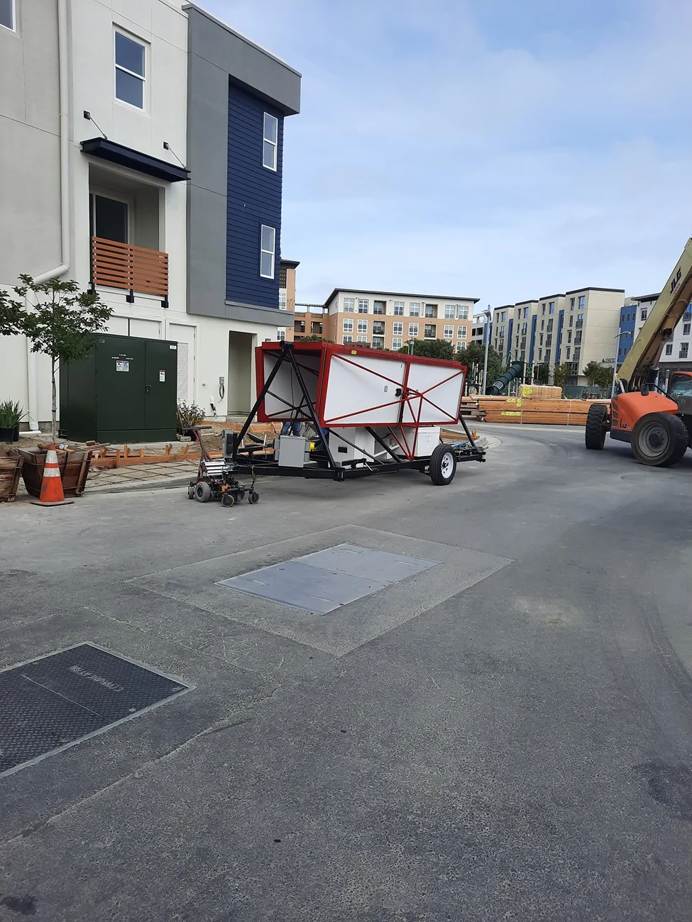

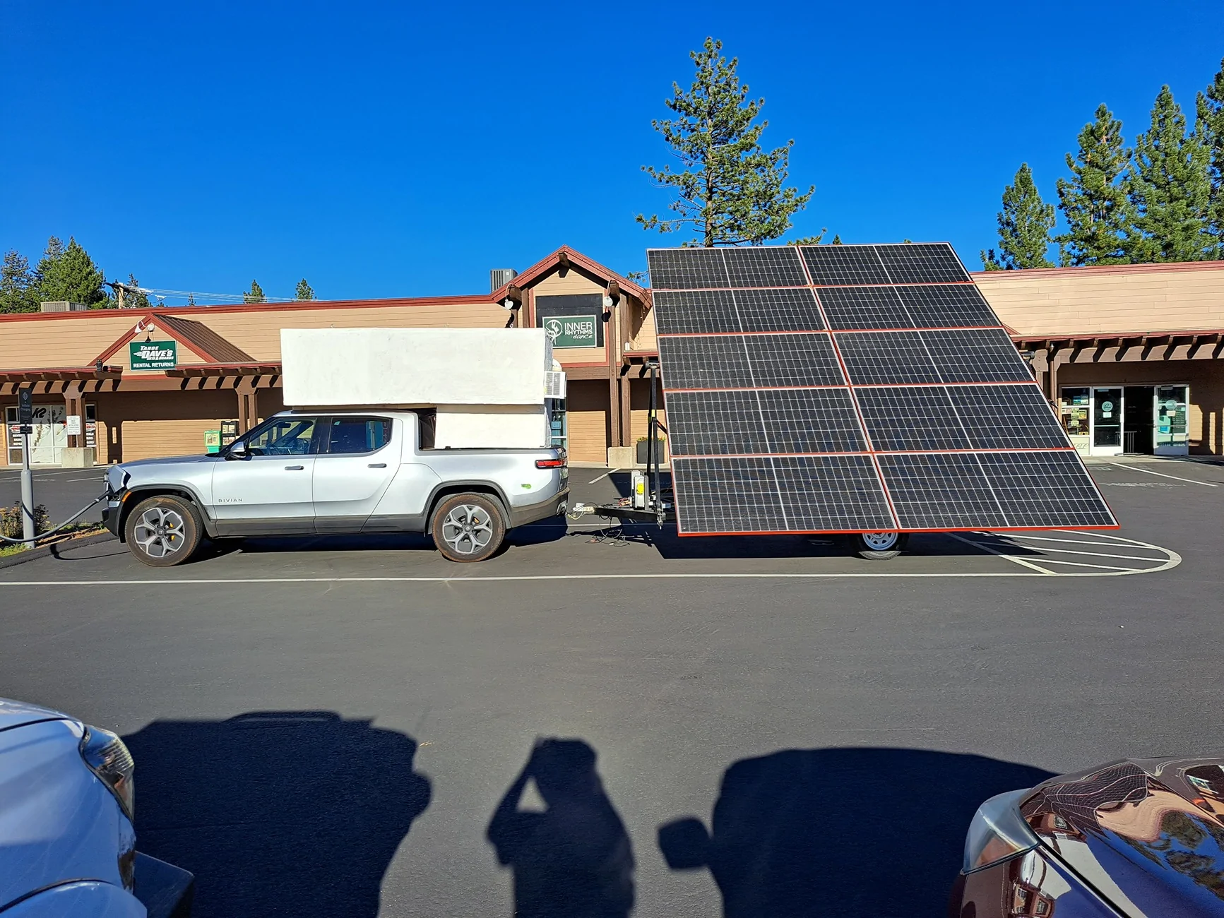

This is my solar powered trailer which puts out 5 1/2 kilowatts in the array which charge my electric car in Burning Man and which I do rent out to Ye
jerry
jerrold
Sep 19, 2026
R1T
5 1/2 kilowatts in the, 60 kilowatt hours of batteries lithium ion batteries, two 12 kilowatts inverters
Give me a call I live in Mountain View 415505 3101 If you'd like to see it

Thanks for the offer - but it's a long way from here in N Va to SF, practically coast-to-coast.
So what did it cost you to build?
