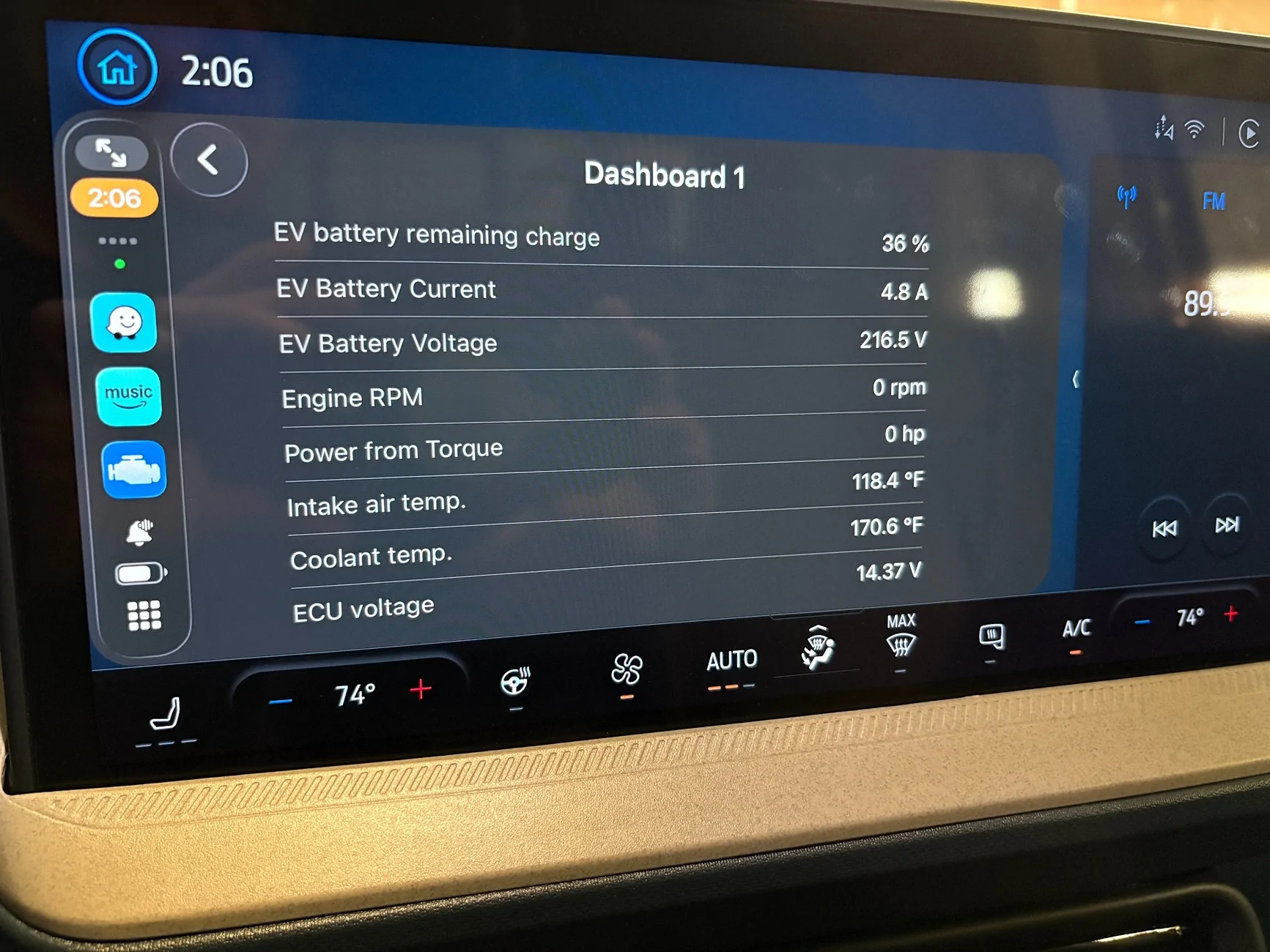

According to the carscanner I have on my hybrid MAV, the EV battery is 220 volts or there-abouts.
The high-voltage (HV) hybrid battery pack in the Ford Maverick Hybrid operates at a total nominal voltage of up to approximately 450 volts DC.
Key Details of the Maverick Hybrid HV Battery
  • Capacity: 1.1 kWh lithium-ion battery pack.
  • Location: Mounted underneath the vehicle/floorboard area.
  • Function: Powers the electric traction motor, enables low-speed electric-only driving, and works with the eCVT motor/generator to crank and start the gasoline engine.
  • Safety: High-voltage cables and components are wrapped in orange insulation and marked with warning labels; service procedures require proper depowering to avoid severe electrical shock.
2022-2023 Maverick Hybrid HV Battery Removal Guide (PDF)
To prevent the risk of high-voltage shock, always follow precisely all warnings and service instructions, including instructions to depower the system. The high-voltage system utilizes approximately 450 volts DC, provided through high-voltage cables to its components and modules. The high-voltage cables and wiring are identified by orange harness tape or orange wire covering. All high-voltage components are marked with high-voltage warning labels with a high-voltage symbol. Failure to follow these instructions may result in serious personal injury or death.

From my understanding, the vast majority of EV classified as "400V" are actually less than 400V.
My Mach-E is classified as 400V, and was ~360V
My GMC Sierra Denali is classified as 400V and is actually ~330V
(Although during DCFC, if it senses the charger supports 800V charging, it will connect the 2 packs in series and thus raise the voltage to 660V (Anything over 400 is marketed at 800V architecture. Just like 300V batteries are marketed at 400V)
I thought I read somewhere that Maverick Hybrid HV battery voltage was around 220V. But it was a couple of years ago.

HVB Voltage changes depending on how full the battery is. It reaches its highest voltage when fully charged (near 500V) and drops lower as the energy depletes (closer to 300V).
400V Battery Architecture
Although the term might suggest otherwise, a 400-volt architecture doesn’t have a fixed battery voltage of 400V. Its voltage range is between 300 and 500 volts. The voltage will change depending on the battery’s state of charge (SoC), temperature, age, and operational conditions. Anything within this range is considered 400-volt architecture.
400V systems have long been the standard in EV technology, powering electric vehicles. They cost less than 800V systems thanks to well-established manufacturing and high-volume components, making 400V EVs more affordable for consumers.
EVs with 400V battery systems power their electric motors and work with both 400V and 800V DC fast chargers. However, when connected to an 800V charger, they’re limited to 400V output, which may slow charging depending on the charger’s current.

I agree that pack voltage changes as the SOC changes. I actually monitor the PID for both voltage and SOC of the HV battery in the Powerboost, Mach-E, and Sierra EV while I drive.
All are so called "400V" high voltage batteries. But none of them, at 100% SOC, reach 400V.
Obviously, the maximum voltage for the pack is determined by how many cells are in a module, and how many modules are then connected in series.
I have not built a PID dashboard in my daughter's Maverick, admittedly. So I don't personally know for sure what voltage the pack is at or near 70% SOC. The Maverick Hybrid battery is similar to the F150 Powerboost battery, in that it is "small", by EV standards. And Ford protects that battery health by limiting its operating SOC between ~30%-70%, based on a quick Google search. (very similar to the Powerboost, which I do have 5 years of monitoring)
If I had to guess, Ford has the Maverick battery assembled into a fashion that has the battery voltage in the 220-240V range, just as the PID in an earlier post image showed.
