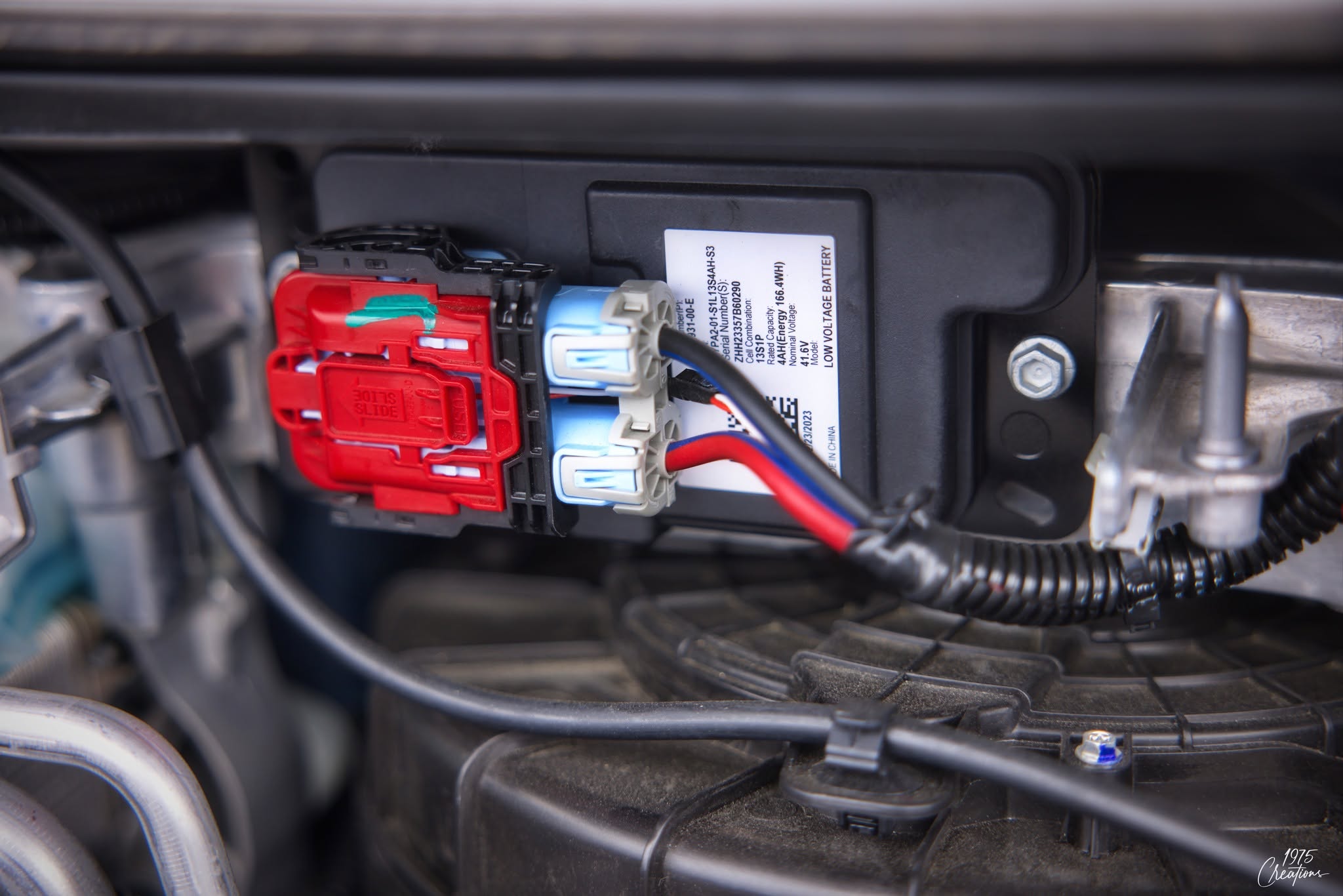

Tesla's 48 volt battery is small. I expect it would also be small in the Fathom.
Cybertruck's "Low Voltage Battery"
-13S1P
-4AH (166.4Wh)
-41.6v Nominal Voltage
Each of the 13 cells in there are about 3.2vdc
-13S1P
-4AH (166.4Wh)
Edit: Might have to eat my words. Thanks for posting.
